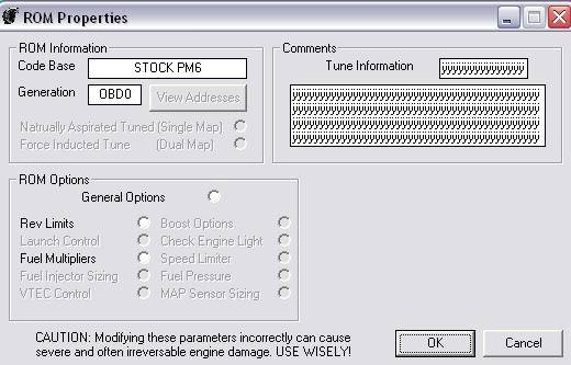

I cann't find plugins for lauch control or boost options and those things anywhere?? Where can I find them?? Thnx

u dont need plugins for those
they are within the options tab on the actual ROMeditor

owk but this is the problem:
I cann't click on the options, you see..

I just discoverd when I use a .bin file with boost, I can use the options.. But is there a possability to use the plugins without using boost maps?????

i take your trying to do this to stock roms???
if so they wont work, you will need to use a stable code
means NG60
and click on options for single map
you can use a dual map, just dont touch the boost side
