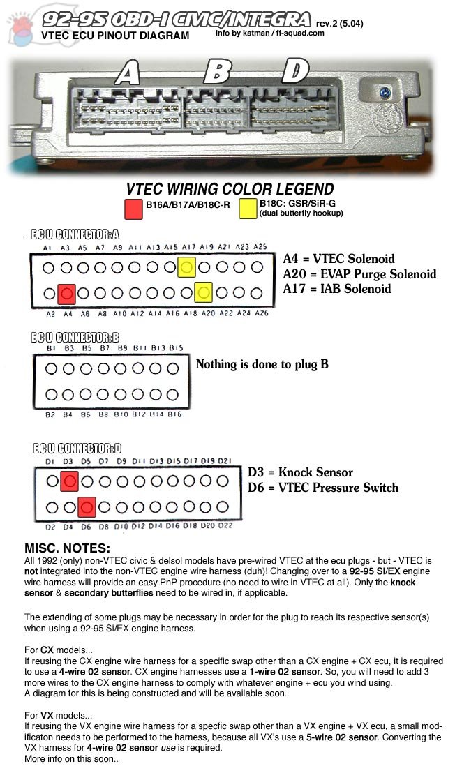

Where can I find a pinout for a P-28 ECU for a 1995 Civic? I`m swaping a D15B8 for a D16Z6. I need to know which pins on the ECU is for the V-Tech so I can run the two wires. Thank you..........

/pgmfi/forum/media/25/25f42b485e88c8a7fc20ecdeab011f16c4f643182af036230c9641dd8e0d2962.jpg
Try searching next time. Don't be so lazy.
Just for kicks I typed in OBD1 pinout on google and the first topic had a reference to it.
