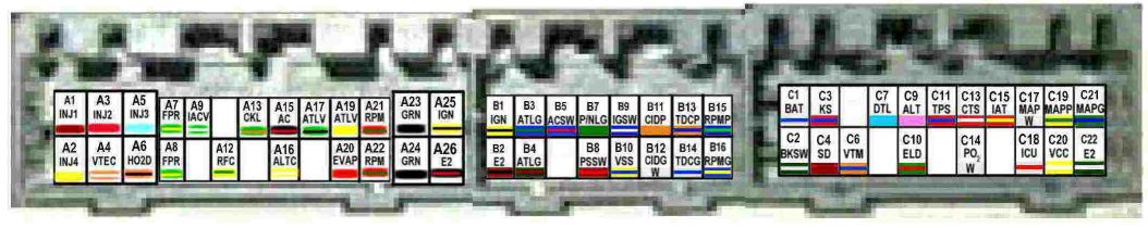

Here is attached the differences between a G01 and a G03. As you can see you can't plug a G01 harness on a G03 ECU and vice-versa.
On the G03 they have grouped together all the pins for the automatic transmission which is the blank part here because it is a manual ECU.

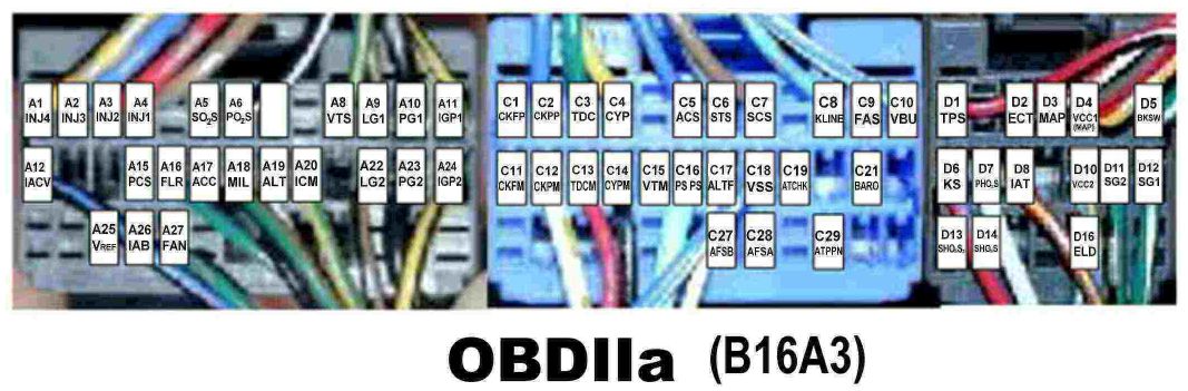

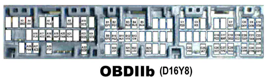

the bottom one is OBD1, the top one if OBD2.
OBD1
OBD2a
OBD2B
