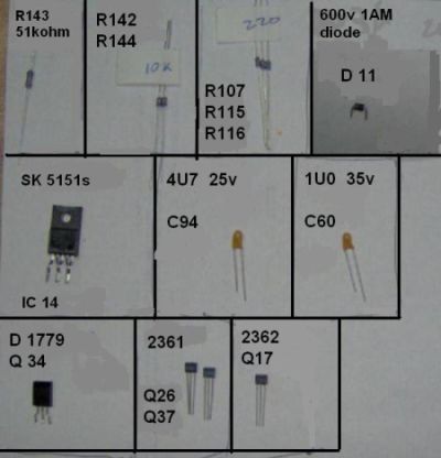

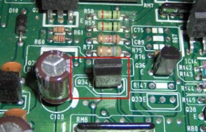

Parts list and locations:
I know my paint skills suck, but...
Notes: 2361 is equivalent to C2785
2362 is equivalent to A143
Now you can start by adding these:

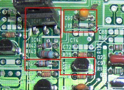

Q37(note that Q37 was already present with a C2785)
R142, 143, 144
C60
a Jumper on J10
IC14

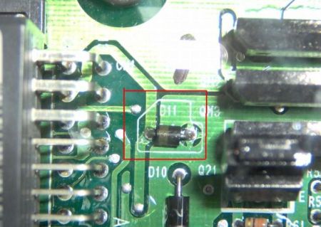

Since your already around there you might as well solder:
D11
Move on to:

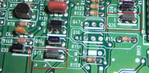

Q34
In the middle:
Q17
Q26

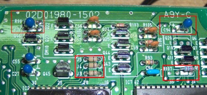

And finally moving on to the right side of the ecu;
Add:
J-5(if applicable, my case already there)
J-3(if applicable, my case already there)
R107
C94(if app., was already there)
Remove:
J-4
R90
C71

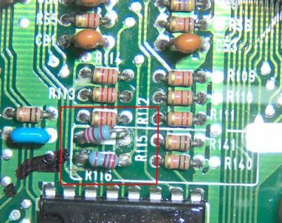

and for the last step:
R115
R116
